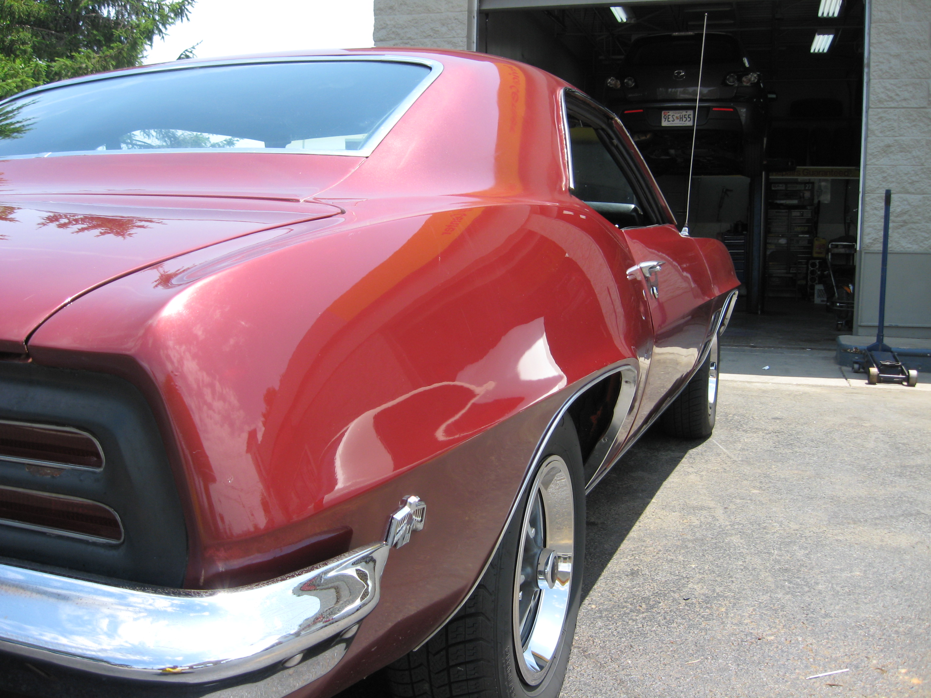

Just got my 69 convertible back from paint and bodywork to replace rear quarters, repair some rust in the lower rear corners of the front fenders and do a complete re-paint in the original Liberty Blue metallic. I'm generally happy with the work, but the gap at the rear of the hood opening is really wide (almost 1/2 ")and the front center of the hood is rubbing when closed on the rubber trim strip. At the rear upper corners of both fenders the flat horizontal surface is fairly exposed from under the windshield trim and the door gaps on both sides, while balanced between front and rear, are also fairly wide. This leads me to believe that the fenders and entire front end are too far forward. I did a search of body FAQs and posts and read where the front end pieces are only adjustable forward and aft and should be adjusted after the doors are adjusted for fit (presumably at the rear edges).
I'm going back to the (dealership) body shop on the 14th for a couple of other things and would like some opinion/confirmation that I should seek adjustment to the front end.

Yup, sounds like you need things moved rearward. It is a very labor intensive project to align the front sheet metal on a 69. If they owe it to you then it's on them. If it's on you be prepared for a big bill for hours of labor.

There is a boatload of adjustment. In your case, the core support needs to move back.

Thanks. It will likely be a negotiated issue. They removed the hood, the front end (less the fenders and radiator support) and the doors and were supposed to align them, although it wasn't a hard and fast part of the quote.
I'm going to see what I can get them to do and for how much.
