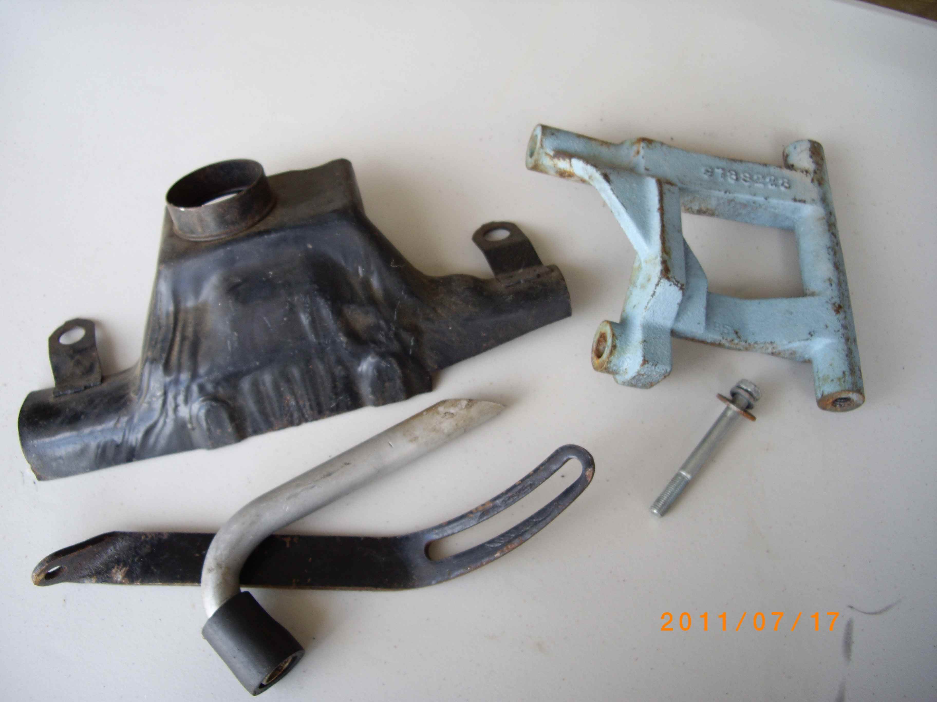

I always heard there was a difference but when I look at them I see none. I used a OEM that I got from Franks Pontiac http://www.frankspontiacparts.com/engineparts/pontiacengineparts.htm
It states it is a 68-69 V8 heat stove. It worked and looks fine on my 400 HO.
Here is a pic of mine from my 400HO

It looks identical to the V8 that franks Pontiac list from what I can tell. I can't see any differences.

Yes... they look exactly like the reproduction ones ames sells for standard v8.
