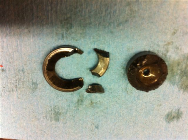

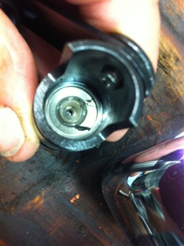

After finding metal in my oil filter and in the container I drained the oil into , I new I had a bad problem. Now I have to take the engine apart, clean and inspect it. When I took the pan off I was pleasantly surprised there was not a pile of shaving, but there was some. I did find a piece of metal that looked like it came from a gear. I got the rockers push rods and lifters out and found one of the lifters broken. The cup broke into five pieces. Push rod is straight and valve looks OK, but I haven't removed the valves yet. Haven't got the heads, cam, pistons, crank etc out yet so I don't know what kind of damage I have down there. I hope it didn't wipe the crank or the cylinder walls. I have this 428 bored out 65 thou already, if the cylinders are scored I'll have to buy another block.
I Googled 'junk' and the Comp Cams logo came up.

I probably should have said "ask where/who makes them', The first set I put in had no identification on the tye-bar, this set says Comp Cams and has an arrow pointing up. Doesn't mean much. I'm sure Comp and the rest of them put tenders out to have them manufactured, I'm sure they don't pic the highest bid, most likely the cheapest.
I'm also quite sure the guys who do the job make them for a lot of suppliers and just put a different logo on the tye-bar, if they use one at all. Both sets came in the identical box. Instructions were the same except the first sheet said to set 1/8-1/4 turn pre-load and the second sheet said to use 1/2 turn. The cheapest are probably not the best.
I looked all over them for some kind of a manufacturers mark but no luck, can't tell you who made them.
Crower says they lead the market in manufacturing high quality rollers. That doesn't quite say they actually make them in-house.
When I had the trouble with the first set the so-called tech rep at comp kept telling me to increase the pre-load 1/8 to 1/4 to 1/2 to 1 to 1-1/2 to 2. 2? I told him if I wanted solid lifter I would have bought solid lifters. When we got to 2 I new they didn't know what they were talking about or trying to cover up for a bad batch of lifters. I phoned Dave and he said the valves wouldn't close at 2, he replaced them and fought with comp himself for replacements. has more clout with them than I as he buys gobs of stuff from them.
The lifter body itself looks new, no marks or scrapes as does the lifter bore.
Camshaft looks good, bearings are shot, I may be able to micro polish out the light marks on the rod journals and the number three main, I will try to polish the scratches on the pistons, touch and go there. May be calling Ross for a new set. Oh boy! I think I ca bottle hone out the marks on the cylinder walls. Other than the lifter and bearings, the pistons took the worst damage. But I havn't taken the valves out yet, I'm kinda worried about the valve guides.
So plan is to put in a solid roller with Crower lifters and rockers. Maybe I'll win a lottery or picking up beer bottles out of the ditches may help. I'm sure Comp isn't going to pitch in.

The filter was full of crap, but the pan wasn't any where near as bad. Most of the stuff got sucked up and caught in the filter, not enough to impede flow I think when first started and the oil pressure is around 80 some gets by the bypass. I had some very small debris in the bearings. The bearings did their job and captured the debris and wore down rather than the journals wearing.
I just noticed, as I was clearing things off the bench making room to strip the heads, one of the PRW stainless roller rockers had made contact with the poly lock. I took two of the rockers apart and found the trunnions worn on both. The trunnion metal is so soft there is needle imprints in the truninion steel. They made the rocker bodies stainless but used soft steel for the pivot trunnions. Gets stupider every minute. That may be where the fine bits came from that failed the bearings. Cliff Ruggles tells me he had a set of the PRW rockers and they filled his engine with metal as well.

Well those sure aren't the same as the comps. The pin/rivet that holds the link on is a lot larger in dia, there are round plates on both sides of the bar rather than just one, and the cup is held in place with a snap ring/circlip rather than a spiral lock. Has a full body as well. I'd like to take one apart and compare it to the comp's guts.
I noticed, when I drilled the rivet off the lifter and took it apart, the plate [metering plate? metering disc?] under the cup does not have any holes in it. My memory is not as it used to be but I thought the plate had holes to allow a metered amount of oil to bleed up through the cup, pushrod and to the rockers. Back in the 60s and 70s we used to put washers between the disc and the cup body, I remember holes in the metering disc. I haven't taken a modern after market lifter apart. Perhaps the cup body doesn't sit down on the disc but rests on the top of the plunger body allowing the disc to move up off the recces in the plunger, letting oil pass around the outside of the disc and up through the cup?

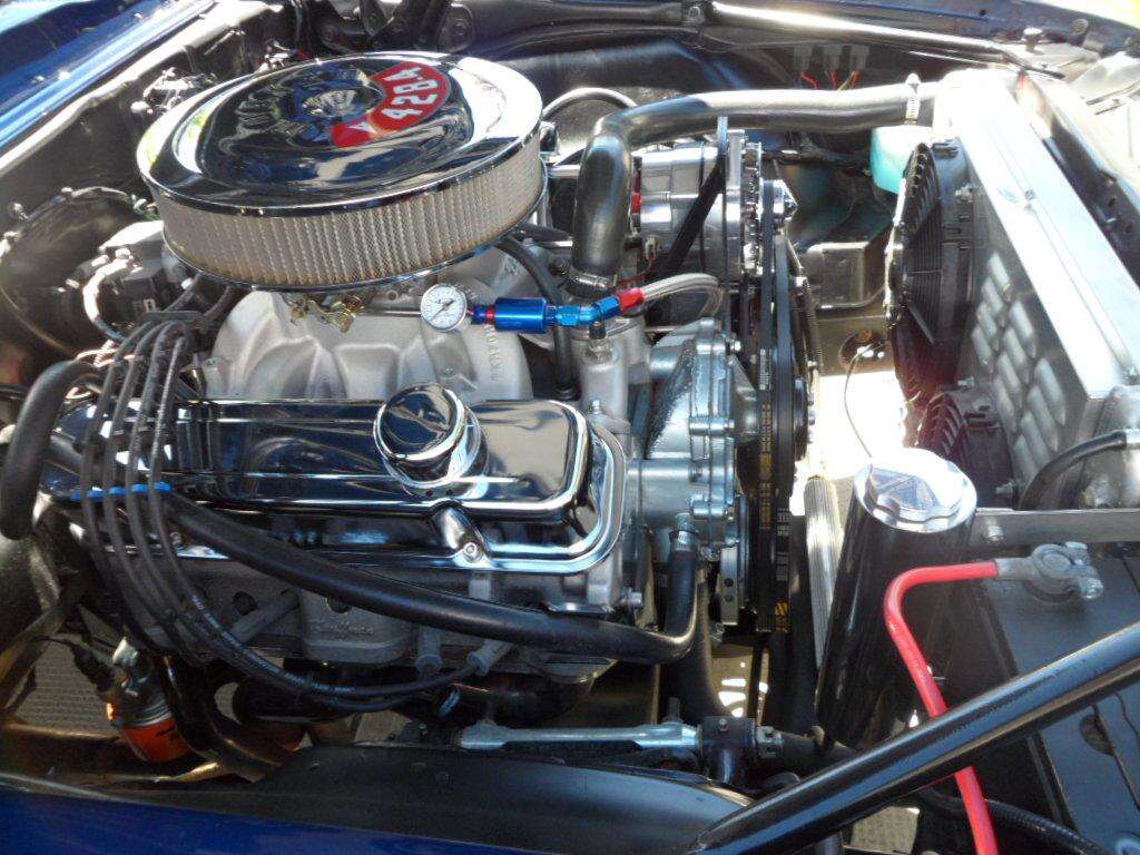

I had the rocker covers off yesterday to check the valve lash and thought I would post an update. It's been 8 years and 35+ thousands of miles with too many over revving runs (7400rpm) and the Crower solid lifters and roller rockers are still going strong. After the pain I had with the comps, I was ready to give up. Thing are so good with the setup I only had to adjust two valves since the last time 9000 miles ago.
The old girl is still going strong, it's in better shape than I am.
