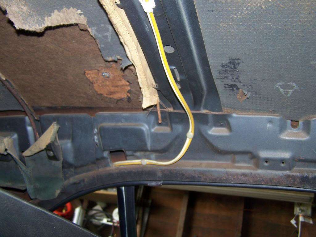

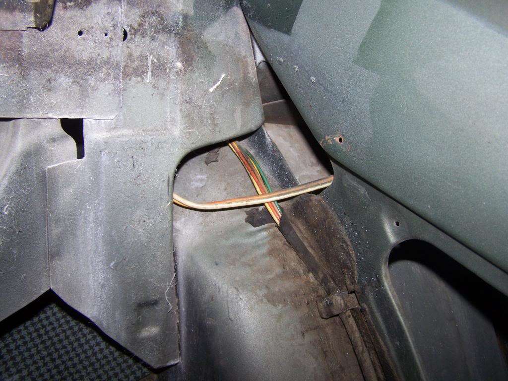

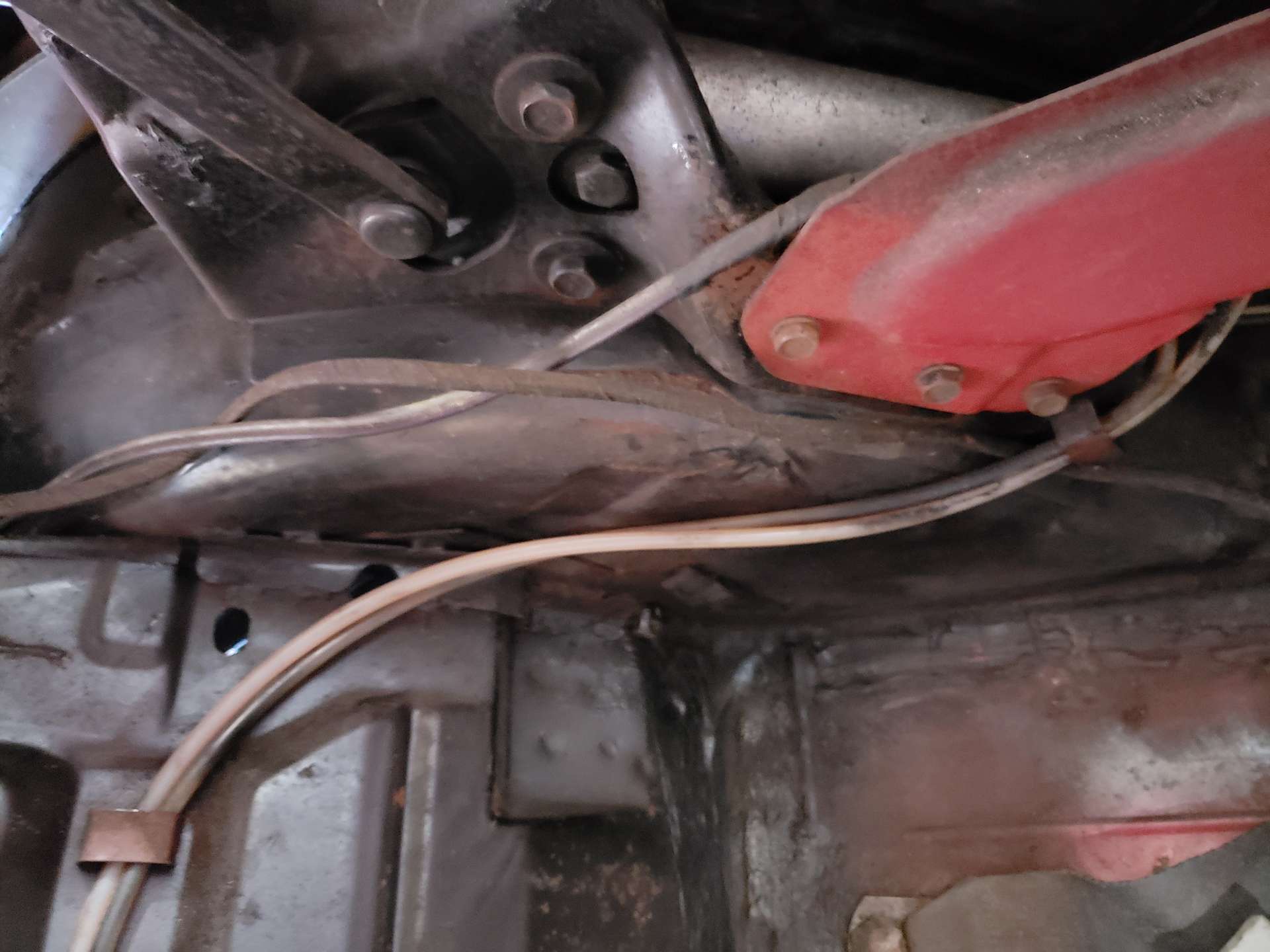

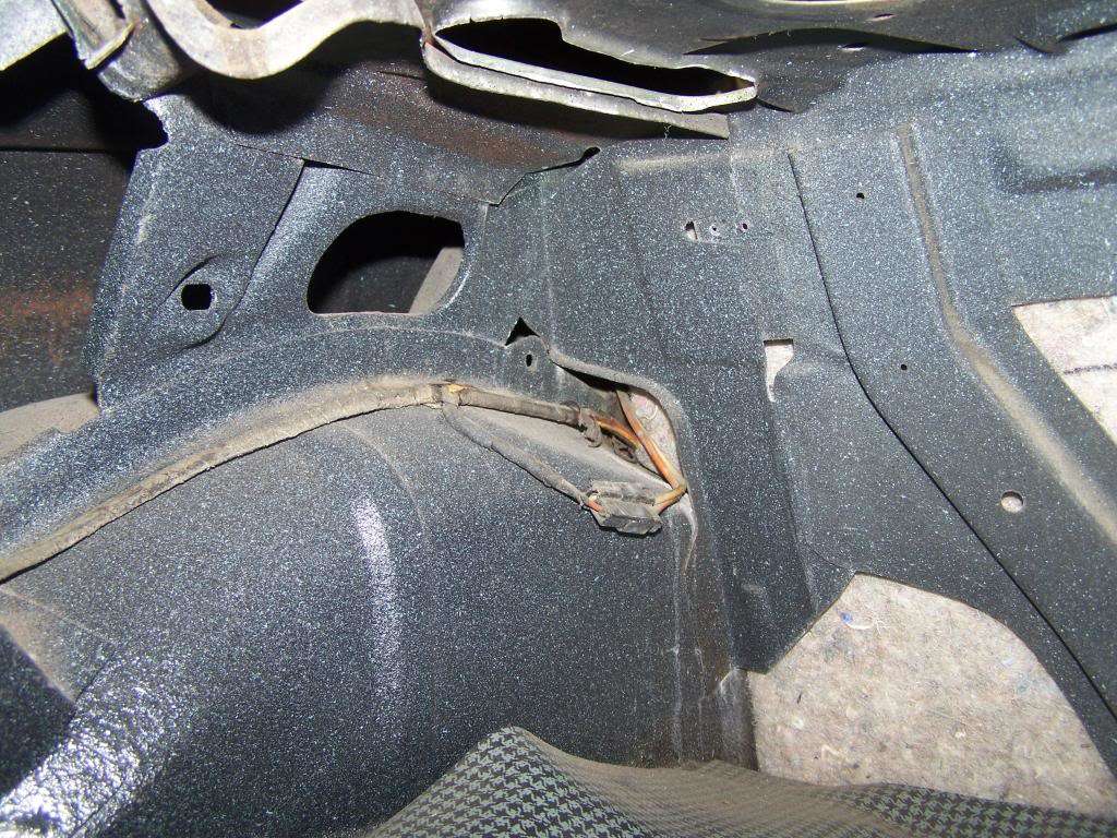

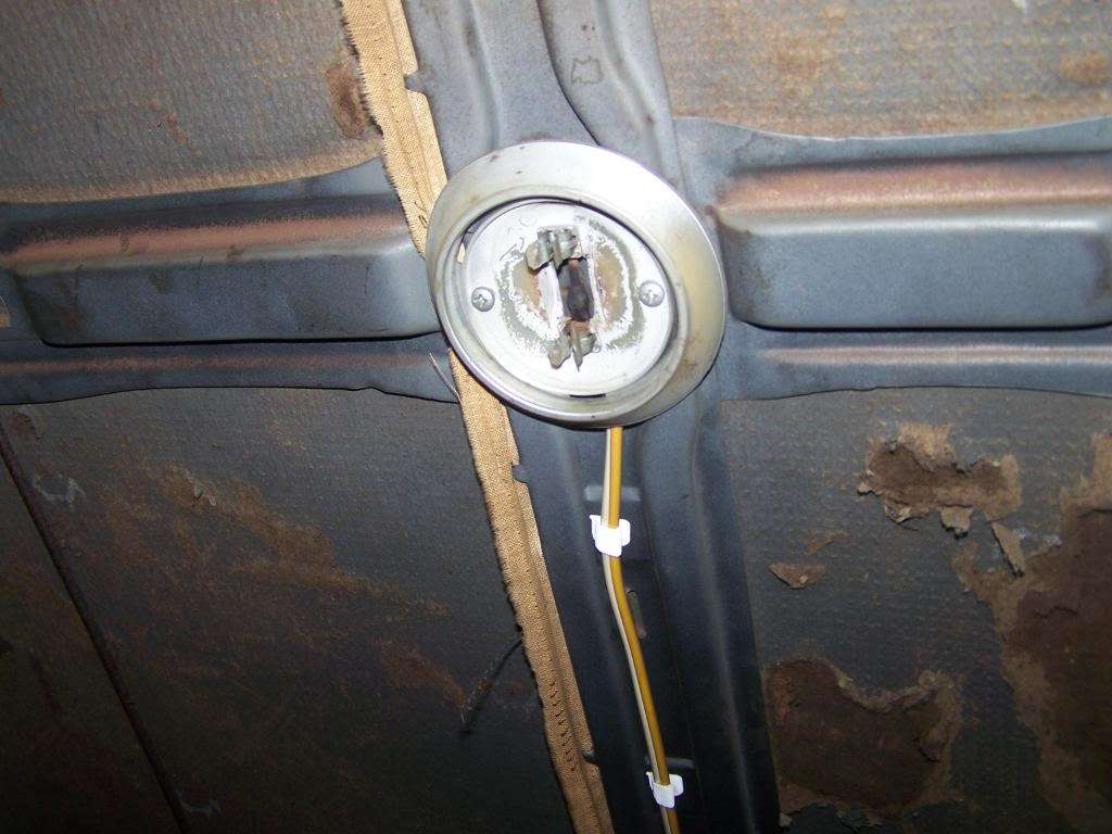

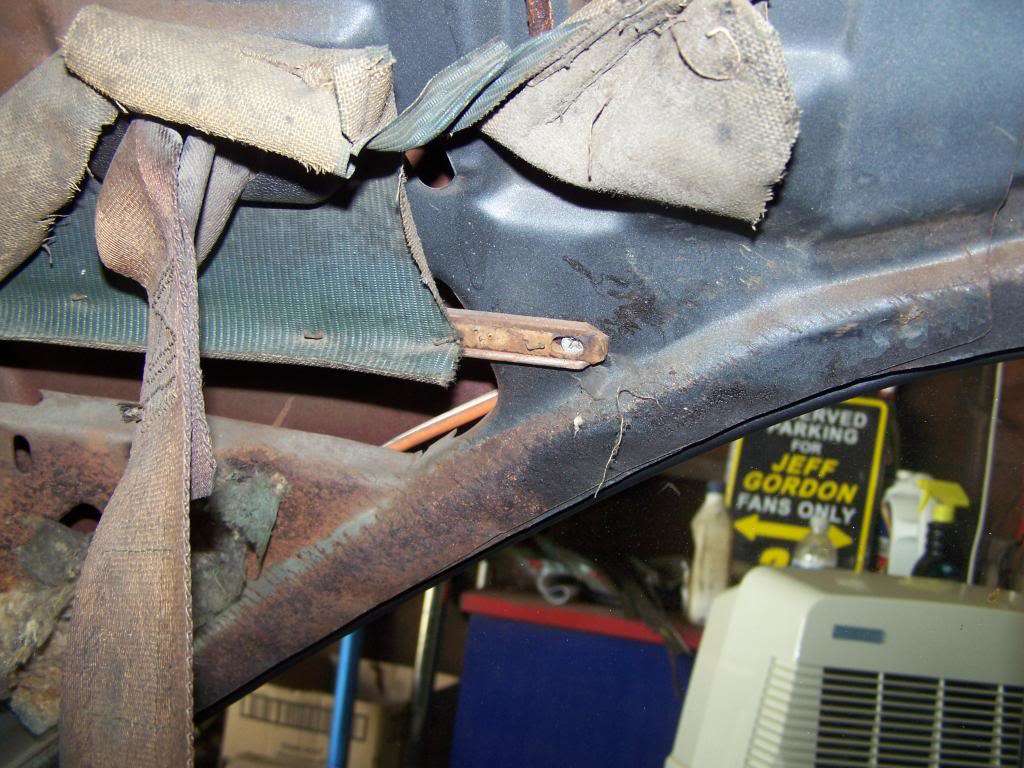

This is my 67 I bought. I could smell mice so I tore out the interior to replace it. The whole tulip panel was one solid nest. Anyway you can kinda see how the wiring goes from the channel up behind the kick panel.
Hell yeah, thanks Birdman!! That is exactly what I needed. Thank you very much!
Thanks for the pictures. It's exactly what I needed. My dome light wire harness clips broke so I had to discard them and I see they don't make those. I may need to just zip tie them up there.
