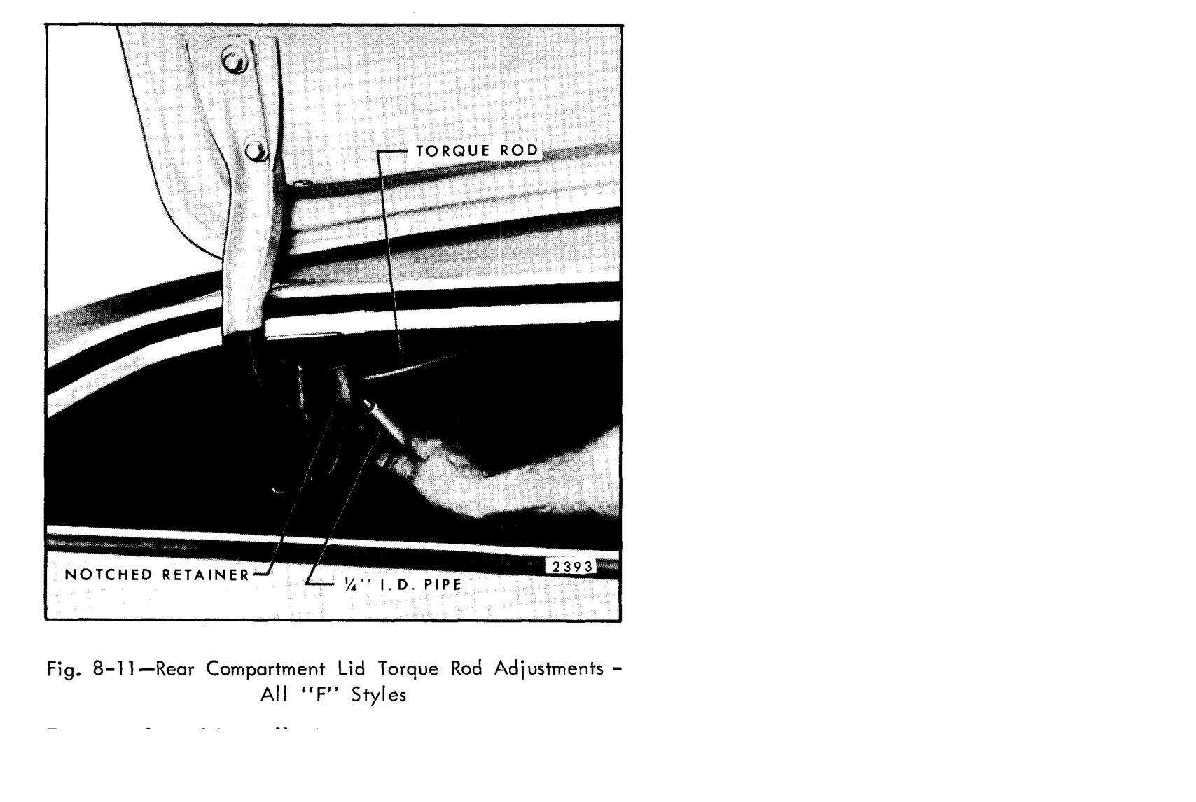

Check your '69 Body By Fisher manual if you have one. The '68 manual (Section 8 - Rear Compartment Lid) shows the GM "F" bodies' tool is a piece of 1/4" ID pipe. Is your new TA torsion rod a different OD then the standard?

I was responding to your question about a special tool, mentioning the 1/4' ID pipe used for the standard rod. If the diameter of the TA rod is more, a different pipe might be needed.
From the 1968 Body by Fisher Manual:
