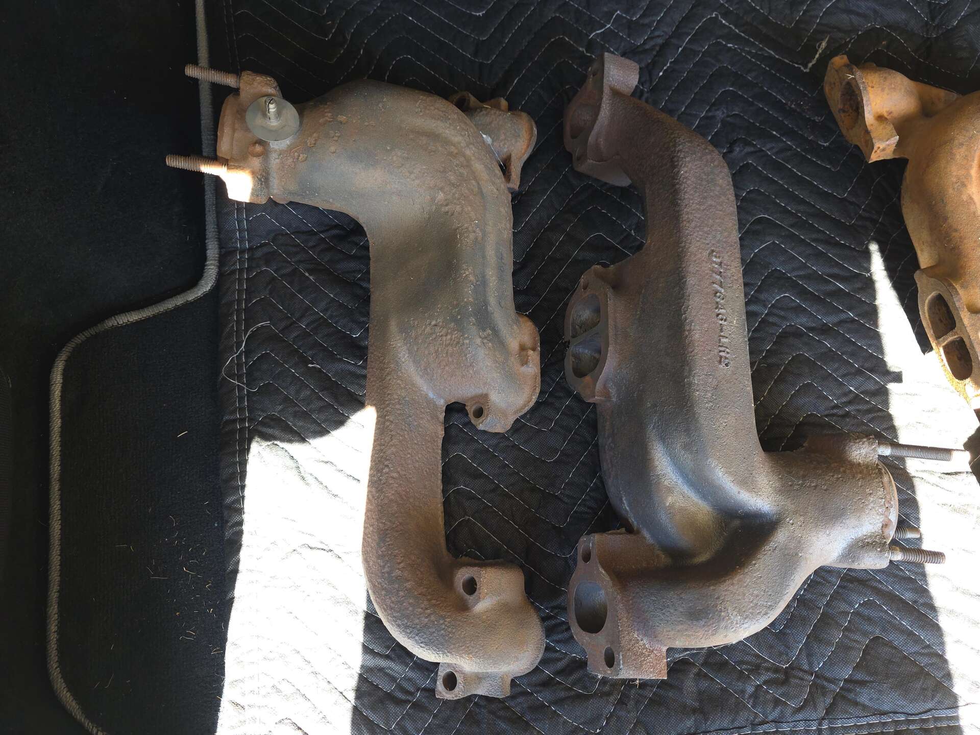

Did anyone solve this issue? Because I have all original 67 Bird, with power steering, and am just getting around to put in OE Ram Air Exhaust manifolds and I can force the manifold in but it is hard pressing against the power steering box. I don't see any way to adjust the 400 engine/mounts to get more clearance and prevent the manifold from being pressed against he power steering box. I welcome any suggestions.
These exhaust manifolds are Ram Air D port and not Ram Air I or later.

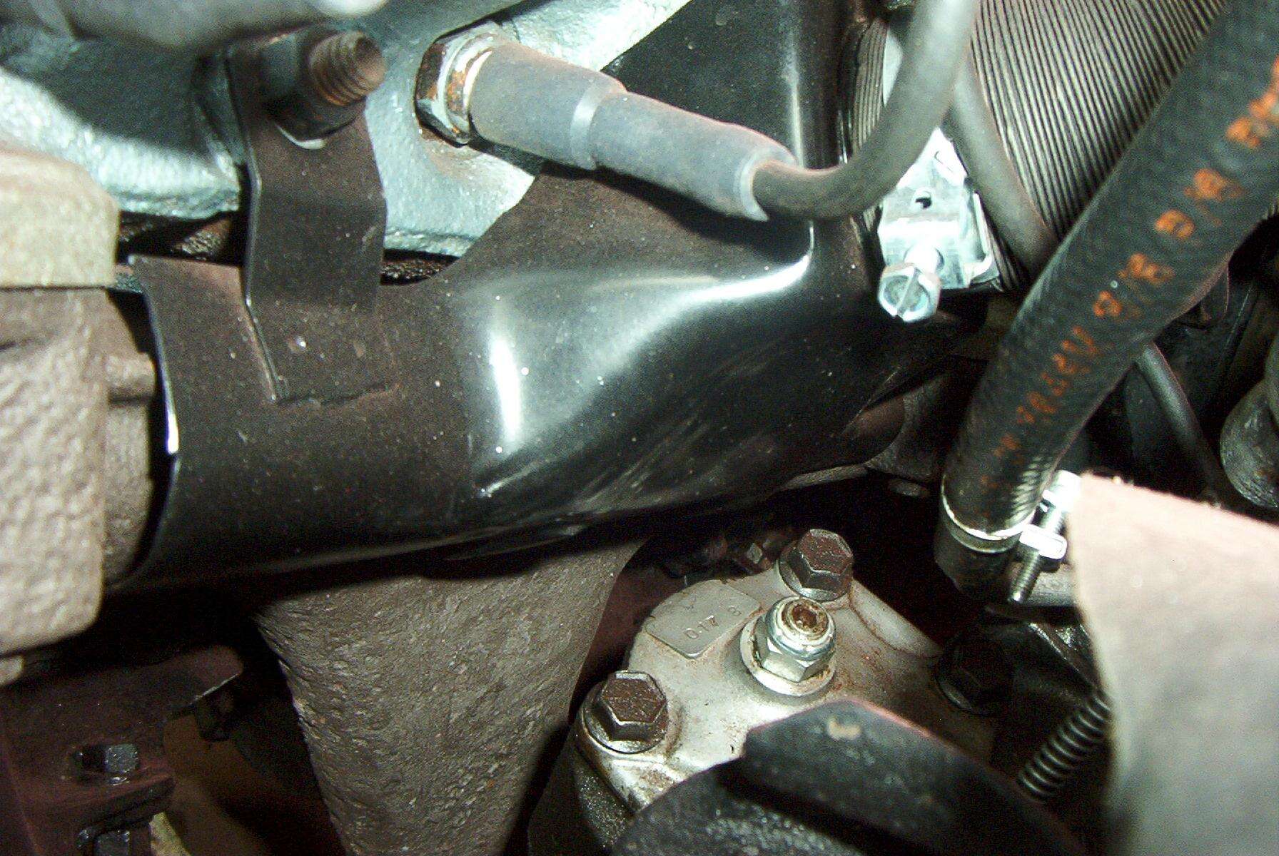

What I was wondering with in the other thread when I asked to see a full photo of them. I didn't know that manifold design was used in a 1st Gen Firebird. The longbranch type HO/RA in my '68 is close but does not interfere with the original steering. Maybe one of the guys here with multi-1st Gen experience will know if the one you have will fit.
'68 400HO Conv.

Thank you for responding. My bird is an earlier production but I am beginning to think I need the long branch exhaust manifolds like you show in your picture. The sets I have (matches 67 GTO numbers) hit the steering box and I can't seem to get even a 1/4 inch clearance. If you know of anyone with long branch for FB, please let me know. What I see on line are not number correct and well too much for my needs. Again, thanks for the input.
