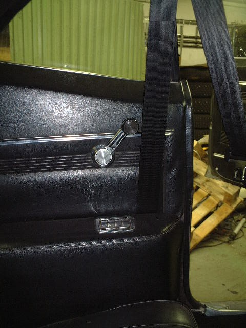

For those looking for a little more info regarding 3 point seat belts, below is a recent exchange of emails with Niklas in Gothenburg.
His installation is similar to Claus'.
There should be 5 images to view as well, assuming I posted `em right.
----- Original Message -----
From: Ridell, Niklas (C.N.)
To: Dave Smith
Sent: Tuesday, December 05, 2006 2:45 AM
Subject: RE: Firebird 3-pt Seat Belts
Hey
You're making me blush...
"His mod was perfect and very professionally done."
Let's see if you think the same after seeing the pictures.
Anyway, I will try to describe the modification:
I used a generic aftermarket kit. The kit was made in Germany (I live in Europe) but I'm sure you can find something similar in US.
I managed to hide the belt retractor inside the rear seat armrest. The belt comes up between the armrest and the quarter panel. I just had to shim out the armrest enough to let the belt slide freely. The only problem here is that the body structure behind the armrest is quite weak with lots of holes and stuff. I welded a patch over this area stretching down to the floor as well for support before I bolted up the retractor.

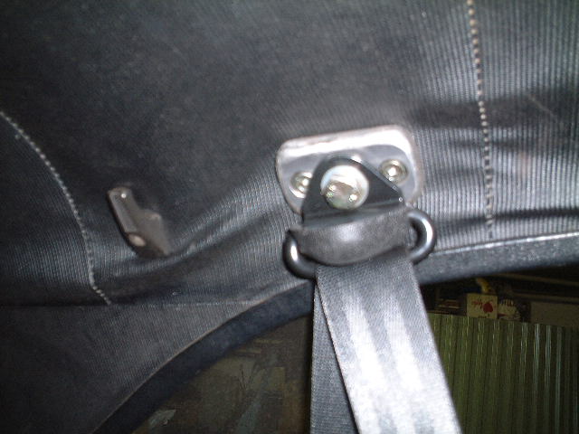

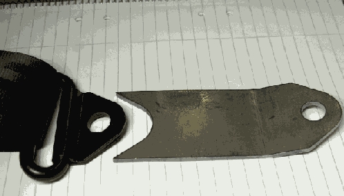

In the roof I first bolted a block of steel with recessed holes for allen head screws. The screws are recessed to allow the swirl bracket to swing around free. I also made the block thick enough to provide plenty of threads for the belt bolt. The block is bolted to the roof in what is supposed to be the original shoulder belt position. I was expecting to find some sort of weld nuts in the roof but couldn't find any. Maybe I was searching in the wrong position. I could find a sheet metal "pocket" though which I used for fixation. I drilled thru the headliner and this sheet metal pocket and then made another block of steel with two threaded holes which I slid into the pocket. I managed to do this without removing the headliner, just lifting it a little at the sail panel.
For the other belt fixation points (at the rocker and the belt buckle) I used the original weld nuts.
When the modification was completed I found that the belt geometry sucks. The roof fixation is sitting too high up making the belt rub against your neck. I'm not sure but I suppose this occurs also if you have the original shoulder belt setup. I ended up extending the swirl bracket. This improved the situation a lot. In the pictures you can see the laser cut sheet metal pieces I welded in.
Ok, check the pictures and let me know what you think.
/Niklas

Great that you touched base with Niklas and got an updated thread from him. As you can see in his pictures, he did do quite a bit of modifications, but for all the right reasons.
I was very impressed with his work when he and I talked and shared info last spring. Very nice fellow, and good friend of Bjorns.

Robert, there are important and extensive mods needed to truly set the FGF up for success when it comes to safe 3-point seatbelts. Niklas modified and created new parts to achieve that.
Yes, we can all install generic kits that fit in our FGF birds (but don't truly protect us), or rely on the original 40-year-old 3-belt system that came with some of our cars (forget that!).
The FGF Body needs modified hardware to truly protect us and our loved ones while we drive around town and along the highway.
I've never seen any better and accurate mod than that of Niklas.

A problem with the original seatbelt(s) is that once strpped in, -you are totally pinned down... -ofcause that's because there wasn't any self locking mechanism, as in all new cars..
-Another thing to consider is when installing the seatbelts that high (as original) -seatbelt will rub against neck, -and some might not want the seatbelt to be in the window.
Mind you it's good craftmanship, and is absolutely more safe than original..

I did almost the same, Maybe a little more lazy, didnt thought about hiding it . That was much smother , and a good idee. But however it works fine, even when you have to mount a "child-car-chair" ( hope you understand) . It feels pretty safe to , I have put the biggest metal washer between the upper support point and the bolt to reinforce it as much as I could.
In Sweden you dont have to use safety belt at cars 1968 and older . Dont know how it works in Denmark and Norwegian.

Tommy, great pics! Thanks for sharing them. Of course you are working a convertible so it'd been different.
Niklas's biggest improvement to his Mod package was his elongation of the upper belt extender, and his build-up of the hardpoint that that extender is bolted to.
Those two modifications are critical to our safe modern use of the FGF coupe. The original 3-point upper hardpoint was poorly placed (chokes anyone over 6 feet tall) and the hardpoint was not sufficient to hold a big person during a high-speed crash.
