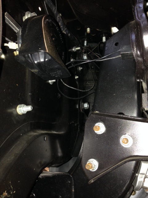

when I try to duplicate view and photo of the masticated filler panels in the above referenced post, I see this:
(not sure if my picture posted)
I seem to have metal filling the gap between rad and sidewall, where other pic shows the filler panel

Thanks Harold. You don't seem to have the lower black valence in place in your photos???
Seems you are using the flexible filler panels both at bottom and sides of the cavity in front of rad.

Some of the pics I have the lower baffle and a couple I don't. I Only have flexible fillers on sides not at bottom.

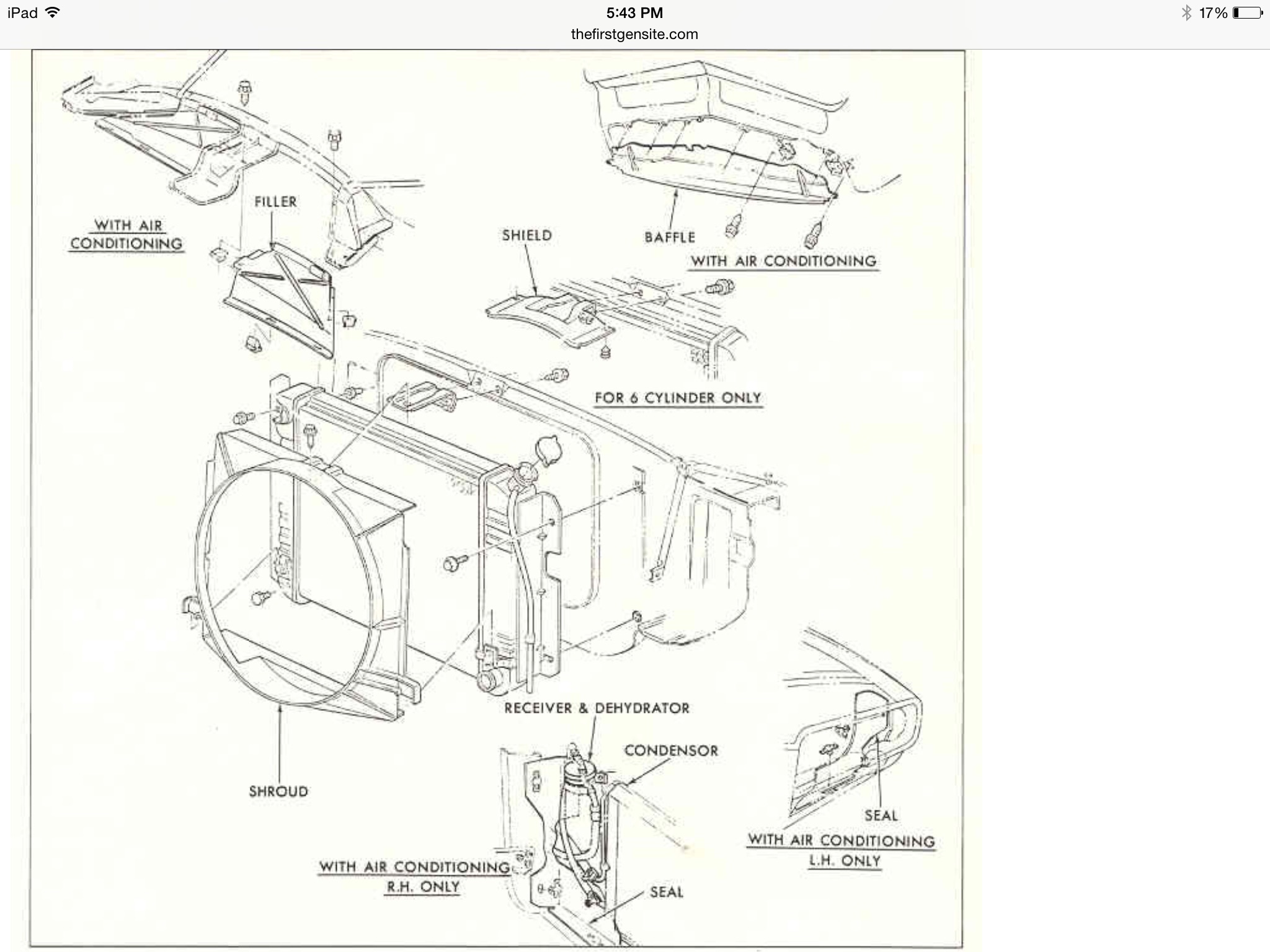

In this picture in the service manual, lower right shows the seals Jim and I have in place.
The metal you see in your picture in the bumper support bracket. These seals attaches to it and the radiator core so there is no open gap in in the corner you see. So all all goes through the radiator instead of forced through the open gaps.

perfect, that diagram really helps, thanks

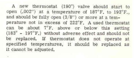

So I went back and checked the service manual. Pontiac used a 190 degree thermostat. It states that it should fully open not to excess 222 F. The boiling point is 258 F with a 15 PSI cap. Most things I've read is operating temperature swing 190-220F. I rechecked the dummy light setting and read it is around 245F.

Thanks Harold.
Sounds like these old iron 350s can safely run at 220 degrees or less, which makes me feel a whole lot better about driving it and turning on the AC,
